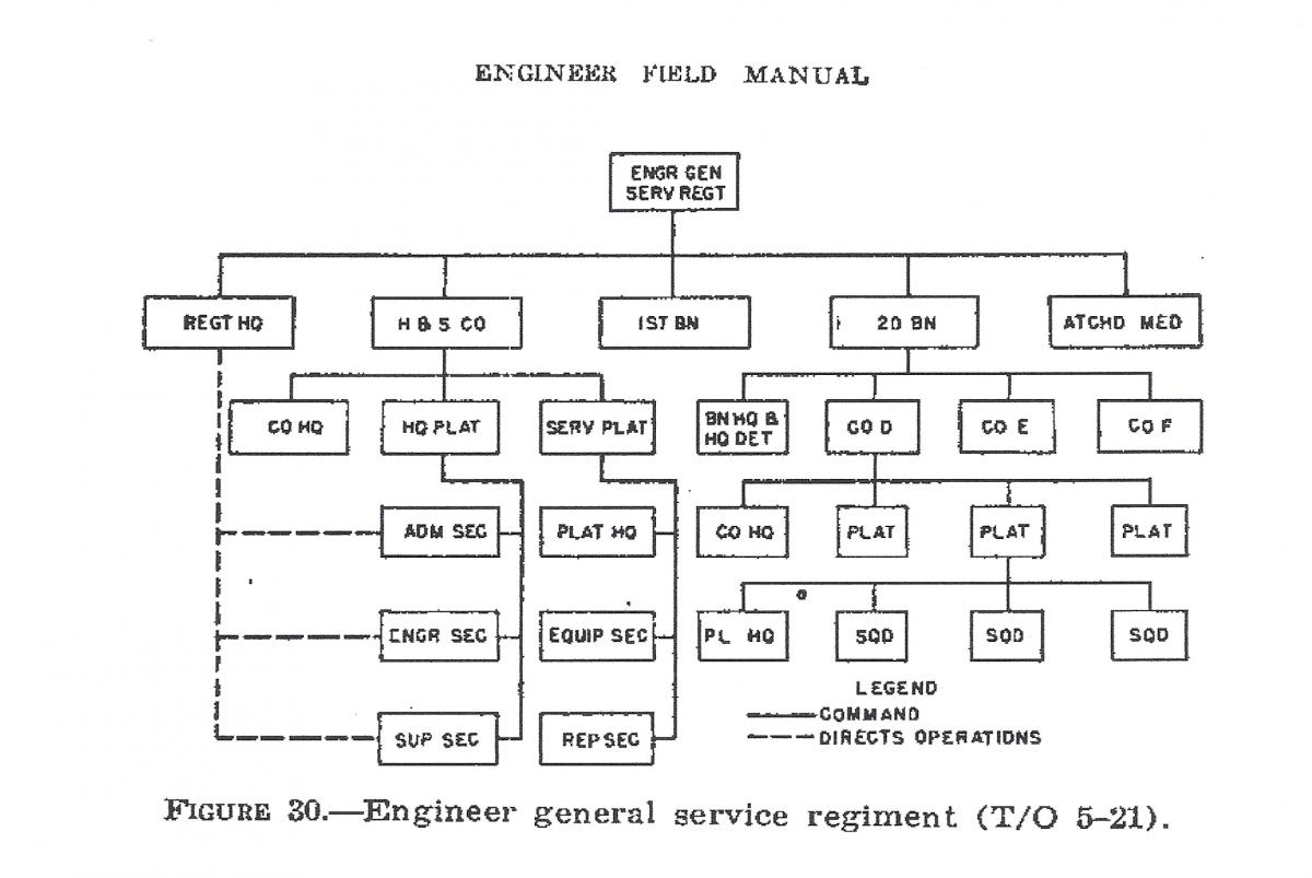

Here is an organization chart for an Engineer General Service Regiment found in Field Manual 5-5, Engineer Troops, page 150.
1st Battalion will be the same as 2nd Battalion ececpt 1st Battalion has companies A,B & C.

What a great find. Perfect. Thanks for posting that for him. :clappin2:
Thanks SonofaMP, that'sgetting close. I am writing the gentleman with some additional questions so hopefully I will have a better understanding of it once I hear back from him too.
Brian
I found this one in the engineers field manual that I think resembles the 157th. Picture2.png
